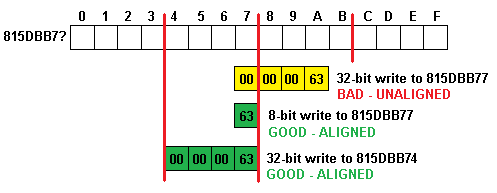

The reason is called alignment.  I suggest re-reading the thread, as it discusses alignment in detail, but maybe a picture will help.
Notice how the row is composed of four groups of four bytes separated by a red line.  Memory is arranged in "words" - groups of 4 bytes.  Each row is four words, each word is separated by red lines.  Your 055DBB77 00000063 would be writing 4 bytes across a word boundary (the red line), which is forbidden.
An instruction is only allowed to touch one "word" of memory at a time.  In my example, I wrote 4 bytes to 0x905DBB74.  The address 0x905DBB74 is "word aligned", meaning that it's a multiple of 0x4 (i.e. the address ends in 0x0, 0x4, 0x8, or 0xC), so all 4 of the bytes I'm writing do not cross any word boundaries.
0x815DBB77 is not word aligned (it does not end in 0/4/8/C).  If you write 4 bytes to address 0x815DBB77, you will be writing 1 byte to the end of the word at 0x815DBB74, and three bytes to the beginning of the word at 0x815DBB78.

...almost.  To be 100% correct, *all* addresses are byte-aligned - 0-F.
All *even* addresses are hword-aligned - 0/2/4/6/8/A/C/E.
You can write a byte anywhere without crossing a red line.  You can write an hword at any even address and you won't cross a red line.
I am not 100% sure, but while it may be *possible* to read or write two bytes at an odd address without crossing a red line (1/5/9/D), I have never seen this in all of the ASM code I've looked at and I would not bet any money on the ability to do such a read/write.
