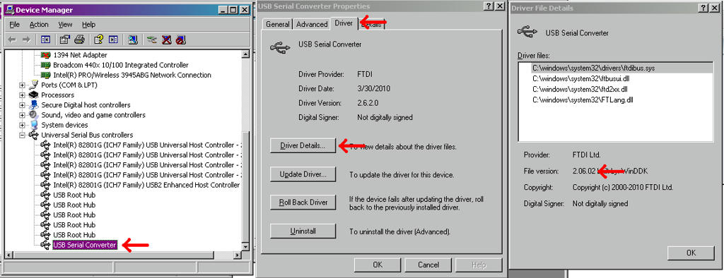

Make sure you're using 2.08.12, from the FTDI website.  Windows Update will not give you the latest driver.  Go here to get them.  http://www.ftdichip.com/Drivers/CDM/CDM20812.zip
Use this procedure to verify what version is installed.  Note: in these screenshots, I have 2.06.02, but I'm using XP, which has not had any problems yet.
