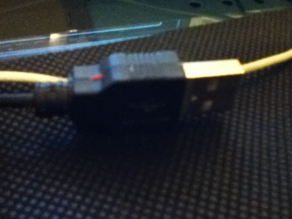

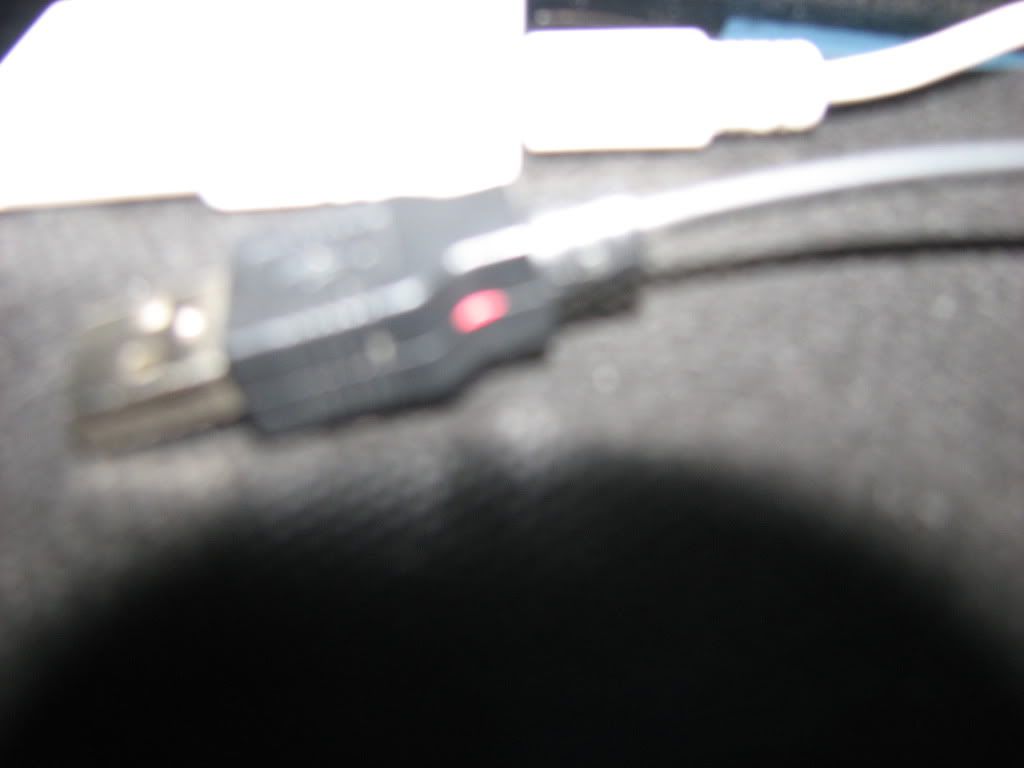

So now I think it was just the cord all along. I remember, when I first got my usb gecko, I got a crappy cord anyways because it has a red wire sticking out (just a little) at the usb part. I'll take a picture and upload to photobucket.
