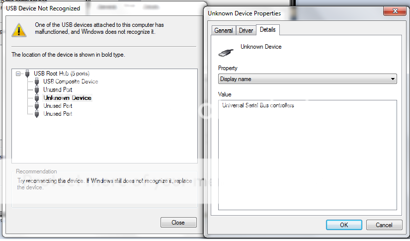

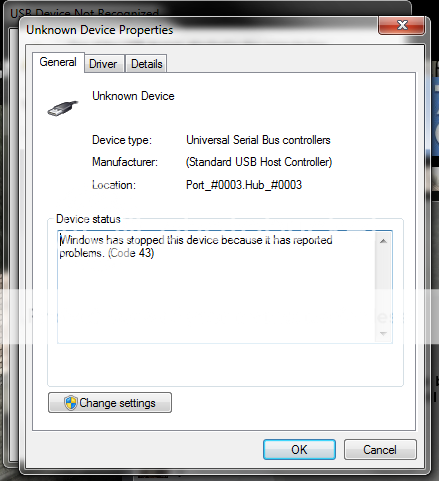

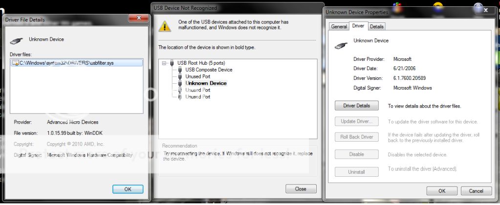

when i just opened up my comp again i got the rare "sighting", the pc indicated error with usb connector ->clicked on it. pulls up a few descriptions....
well these are the print screens i got from that. i still have the windows up.. so any detailed stuff you would like to know i can grab real fast. but i figured these 3 were the most relevant.
sorry for the noobness.. not really sure what that means though.. do i need to just buy a new gecko? (basically meaning this one is fried somehow?) or is there some way of fixing it? ie.. re-installing the data for the usb gecko.. back on it again?

dcx2
You tried a new cord and you get the same result?
That's what happens if the device isn't responding with descriptors during enumeration.  You will get the unknown device.  On the details tab, the Device Instance Id dropdown box will show VID and PID are both 0000
